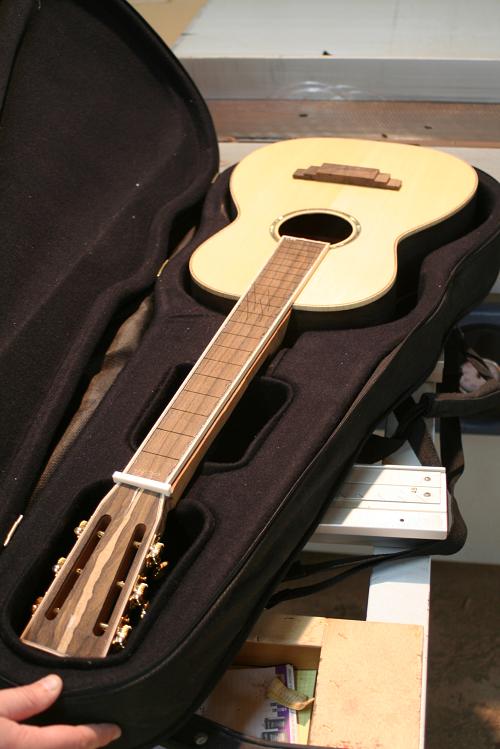

If you can wait a few months, I'll let you know. Here is my current project.

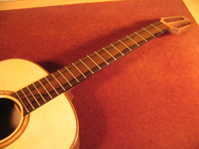

this one(still in construction in the pic) has been completed for about two years now.
i havent experienced any problems with the FB.

This shot was taken in Sergei's shop. The FB was freshly oiled. It has darkened somewhat since then, but the colors are still lovely and you can still see the figure.
The guitar is now over two years old, but as for how it's wearing, I'm not a good one to test that, because I don't wear divots in FBs anyway. I've got these thick pads on my fingertips, so my nails never come anywhere close to the board, and I don't press so hard that the string touches the board, either. In my case, Indian rosewood or spruce or balsa or whatever would be fine.
